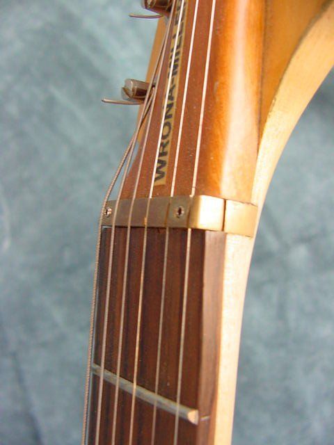

Adjustable Nut Assembly

  • In so far as the truss-rod is permanently fastened to the nut in the Wrona-Miller guitar, the nut is not intended to be shimmed or replaced as in conventional guitars. Instead it is made in two pieces, and easily adjusted with an allen wrench.
